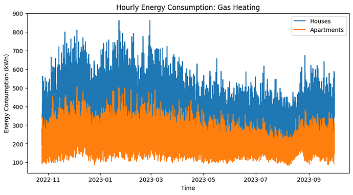

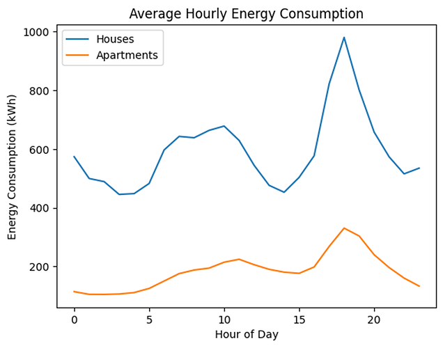

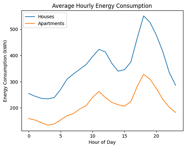

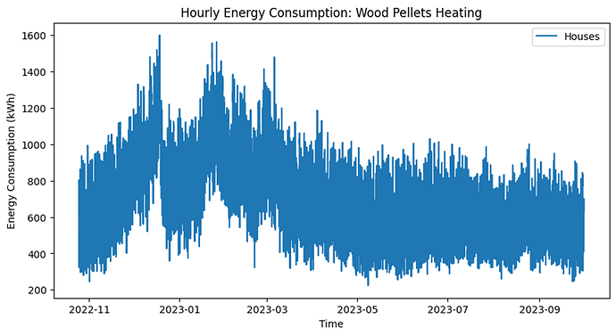

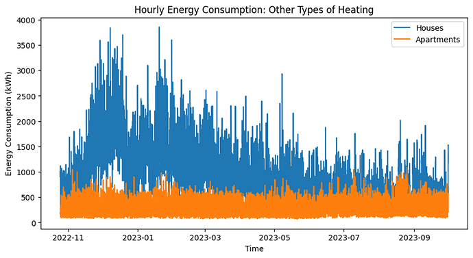

Posting a question on the EtudELEC dataset from @Dalton_Brendan_Ncube here:

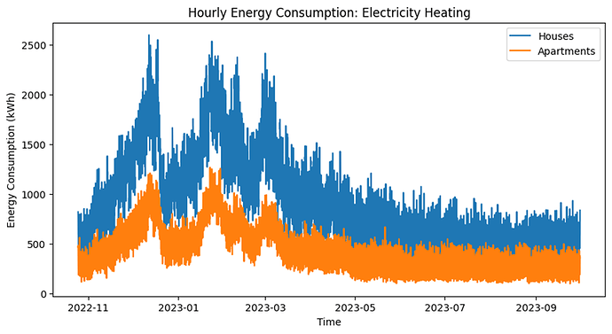

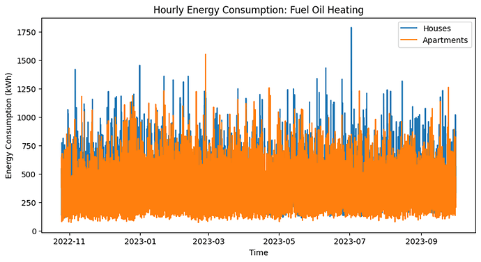

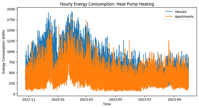

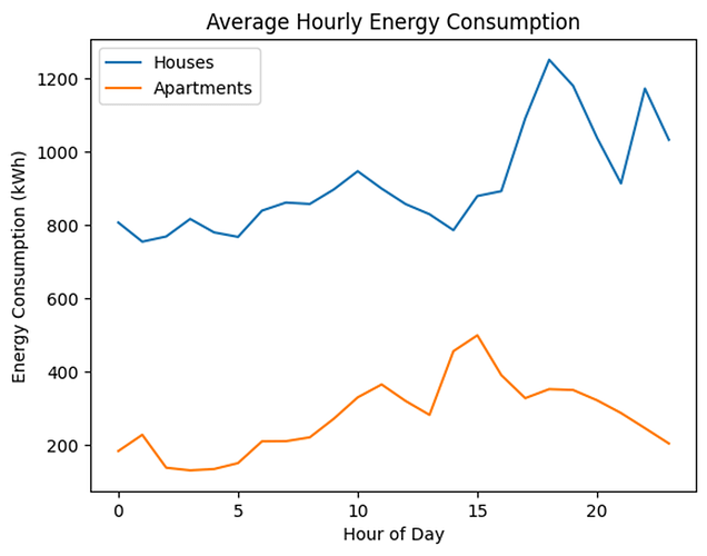

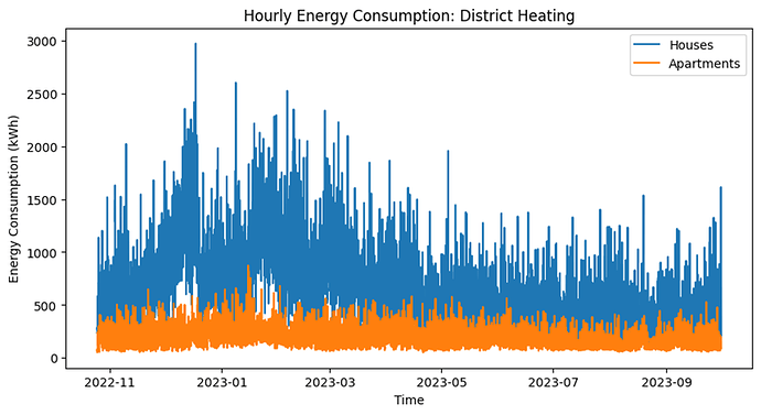

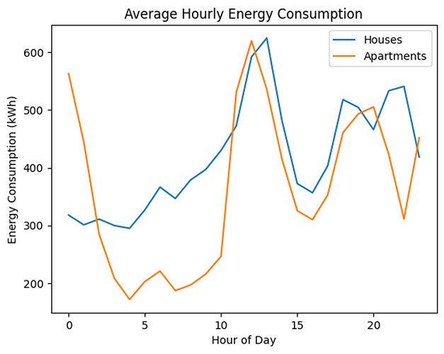

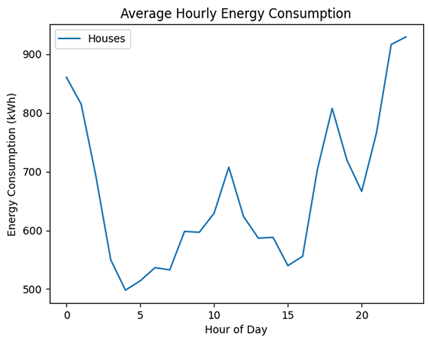

I analyzed the etudelec energy consumption dataset and the trends seem strange or atleast deviate from the norm, i am looking for assistance to understand them
The following are graphs for each heating type

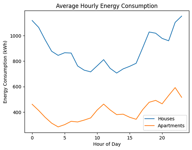

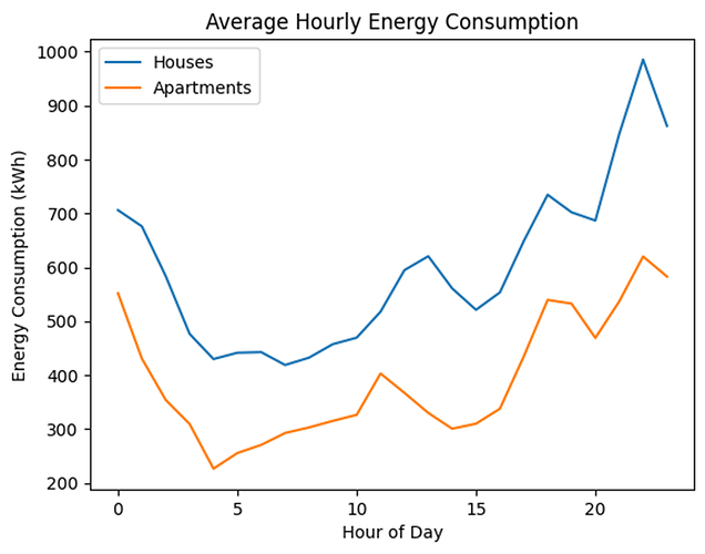

  1. energy consumption throughout the study period obtained using resample ( resampling data into hourly intervals since it is given in 30 mins intervals.
  2. Average hourly consumption obtained by groupby: Grouping the data by hour and calculating the average energy consumption per hour
14 files​

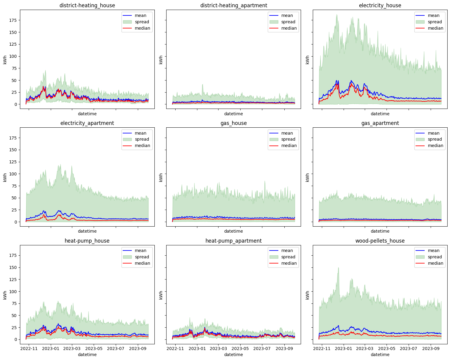

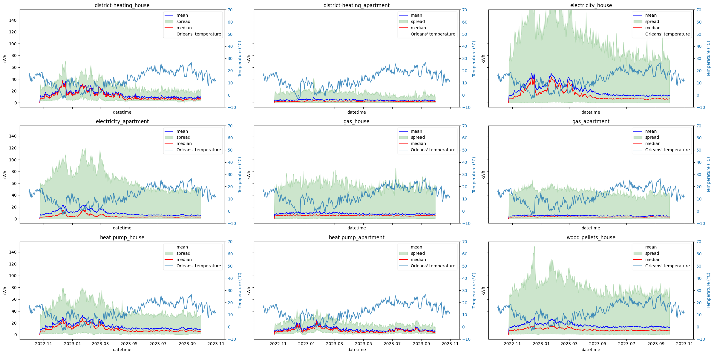

All the groups except apartments and houses that use gas and apartments that use district heating show the same variation in daily energy use (albeit with different levels) as dwellings that use electric heating as seen in the picture below.
Plotting the historically temperature data with the energy should show the coupling more clearly. There’s historically monthly data here: Données Publiques de Météo-France - Données SYNOP essentielles OMM
the values of energy consumption , seem a bit low compared to what i got, may i have a brief description of the model you used
here is how i resampled and grouped the data respectively
#Loading the Data
houses = pd.read_excel(‘electricity_house-summary.xlsx’)
apartments = pd.read_excel(‘electricity_apartment-summary.xlsx’)
Preprocessing the Data to handle missing data
houses[‘timestamp’] = pd.to_datetime(houses[‘timestamp’], utc=True)
apartments[‘timestamp’] = pd.to_datetime(apartments[‘timestamp’], utc=True)
houses.fillna(method=‘ffill’, inplace=True)
apartments.fillna(method=‘ffill’, inplace=True)
Setting timestamp as index for resampling
houses.set_index(‘timestamp’, inplace=True)
apartments.set_index(‘timestamp’, inplace=True)
#Analyzing Energy Consumption Patterns
Resampling data to hourly intervals since its given in 30 mins intervals ikn the original dataset
houses_hourly = houses.resample(‘H’).mean()
apartments_hourly = apartments.resample(‘H’).mean()
Visualizing resampled energy consumption
plt.figure(figsize=(10, 5))
plt.plot(houses_hourly.index, houses_hourly[‘Mean’], label=‘Houses’)
plt.plot(apartments_hourly.index, apartments_hourly[‘Mean’], label=‘Apartments’)
plt.xlabel(‘Time’)
plt.ylabel(‘Energy Consumption (kWh)’)
plt.title(‘Hourly Energy Consumption: Electricity Heating’)
plt.legend()
plt.show()
#Grouping the data by hour and calculating the average energy consumption per hour
houses_hourly_avg = houses_hourly.groupby(‘hour’)[‘Mean’].mean()
apartments_hourly_avg = apartments_hourly.groupby(‘hour’)[‘Mean’].mean()
Plotting average hourly consumption
houses_hourly_avg.plot(label=‘Houses’, legend=True)
apartments_hourly_avg.plot(label=‘Apartments’, legend=True)
plt.title(‘Average Hourly Energy Consumption’)
plt.xlabel(‘Hour of Day’)
plt.show()
The base data is in Watts. So after resampling per hour for mean, you should divide by 1000

This is what the groups daily energy consumption looks like mapped against temperature data from Orleans. The temperature data was sourced from: Le Gardien du Temps | Meteostat
